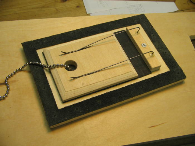

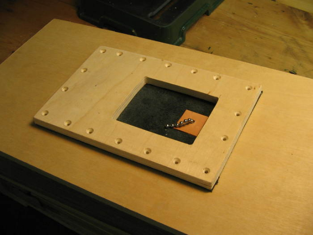

Below pictures of a large valve, but you can make it smaller of course.
You can see the chain that will be fixed on the bottom of the reserve bellows. The chain goes through a little hole in the leather of the valve. By pulling the bulges of the chain through this small hole you can simply adjust the desired top position of the blade and try it out. Once you found the correct position you can fix the chain with a piece of metal with a small slit or something like that.
If the valve makes to much noise, you can simply place a little house with cloth-covered holes over the unit on the outside to filter the noise. Even a simple solution is very effective, especially beneficial for organs with an open front.
